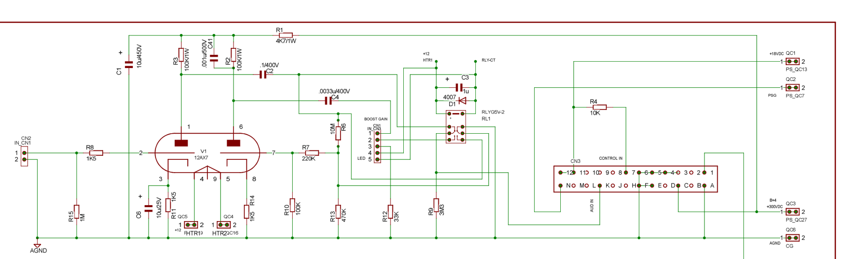

tschrama wrote:
the boost function is SS.. V1 is not switched in or out...
On what do you base this? See circuit diagram below of RM20 input stage showing how the second half of V1 is switched into the circuit when the boost function is engaged. The boost gain pot (not shown) acts as half of a voltage divider on V1:

PostPosted: Fri Jan 13, 2017 1:28 am    Post subject: Reply with quote
Well I was clearly miss informed. From memory I read it in the manual once when I got my RM20 combo. I might have mixed up with a Friendman amp?
Thanks for the correction!
Would be great if you could share the RM20 schemo with me!
